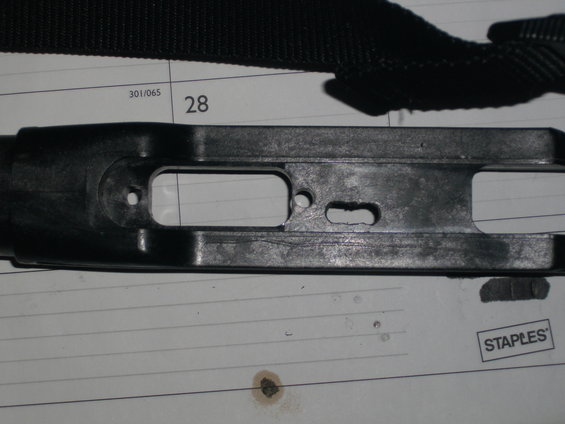

Also, this pic, shows where you need to put the oblong hole for the LSHO lever if you're dealing with a newer 60 or 795 (1994+)
