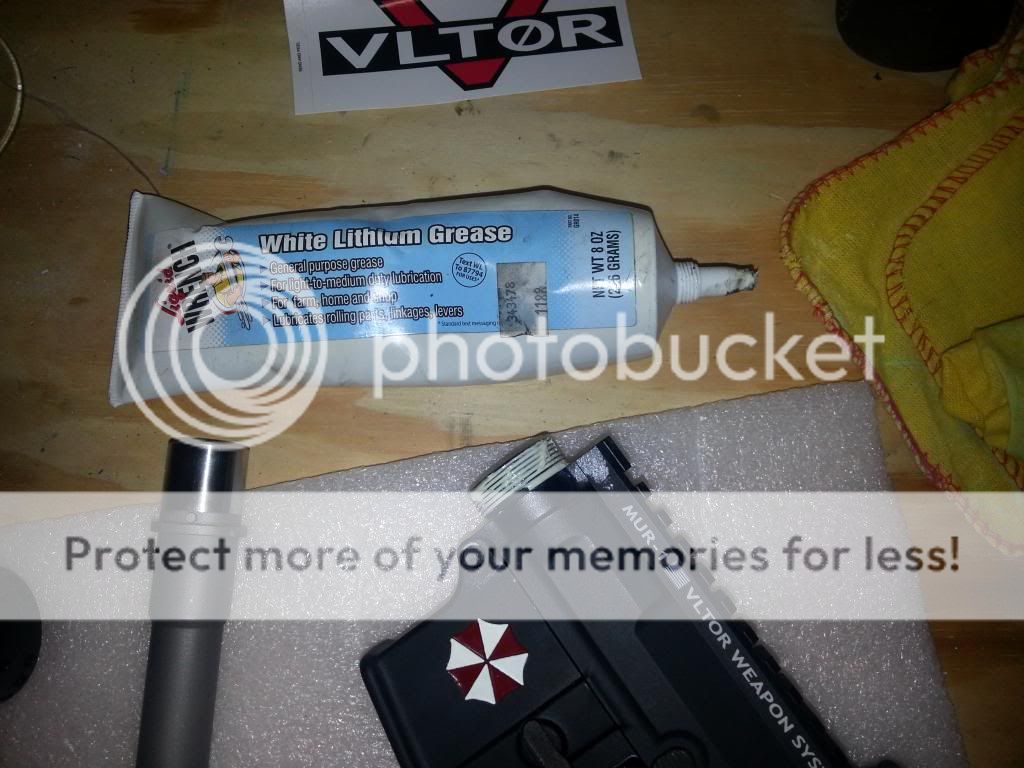

I already assembled the AR15 stripped lower a while back so I don't have pics but I can figure something out if someone would like to see the process.
Umbrella Corps 300 blackout build - AR-15 Discussion
The Lithium grease is applied to the upper receiver threads so the barrel nut will not cease after a few hundred rounds. This will allow you to remove the barrel nut and barrel if you want to later in the future.
Slide the barrel onto the AR upper receiver. There is a small notch in the top of the receiver and a small peg on the barrel so aligning the two is impossible to screw up. Slide the barrel nut over the barrel and hand tighten the Barrel nut onto the upper receiver.
