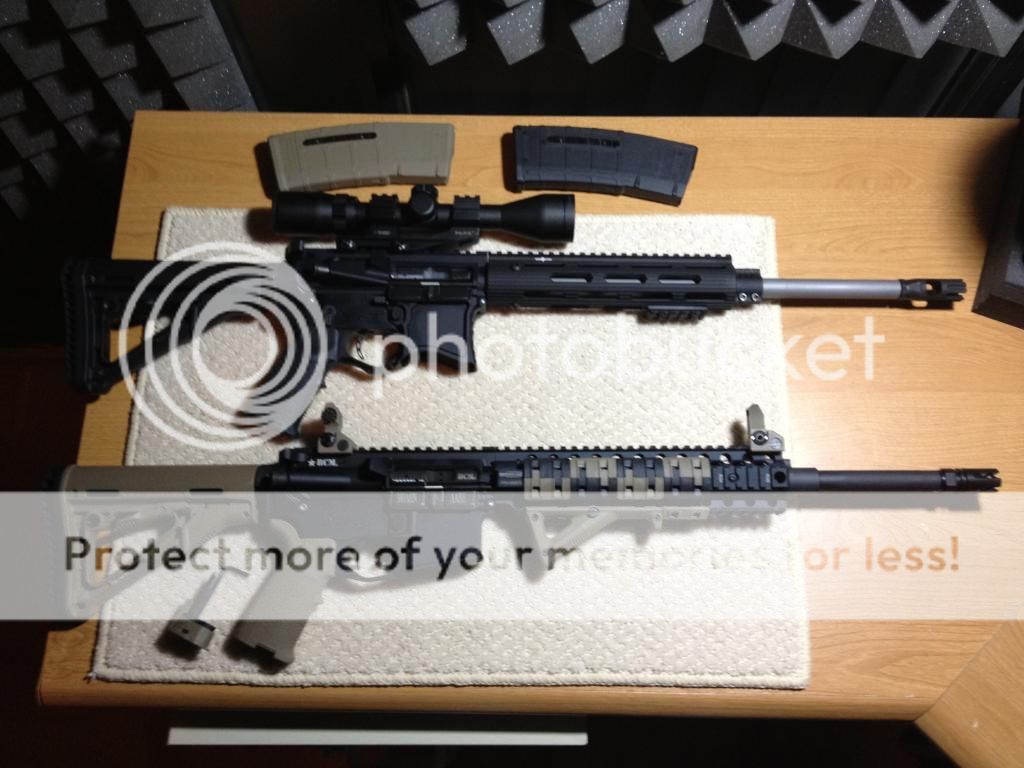

It's a nice looking design and works well, you won't be disappointed! They say it doesn't need to be timed but I did time it so one set of holes is at 12oclock. This puts a flat (no holes) at 6oclock like an A2 flash hider and I think would maximize the compensation effect.
Tinkering with your AR's Timing- Simple Buffer and Springs Swaps. - AR-15 Discussion
Bottom is the DD Superior Suppressor and the top one is a Rainier Xtreme Tactial Comp
