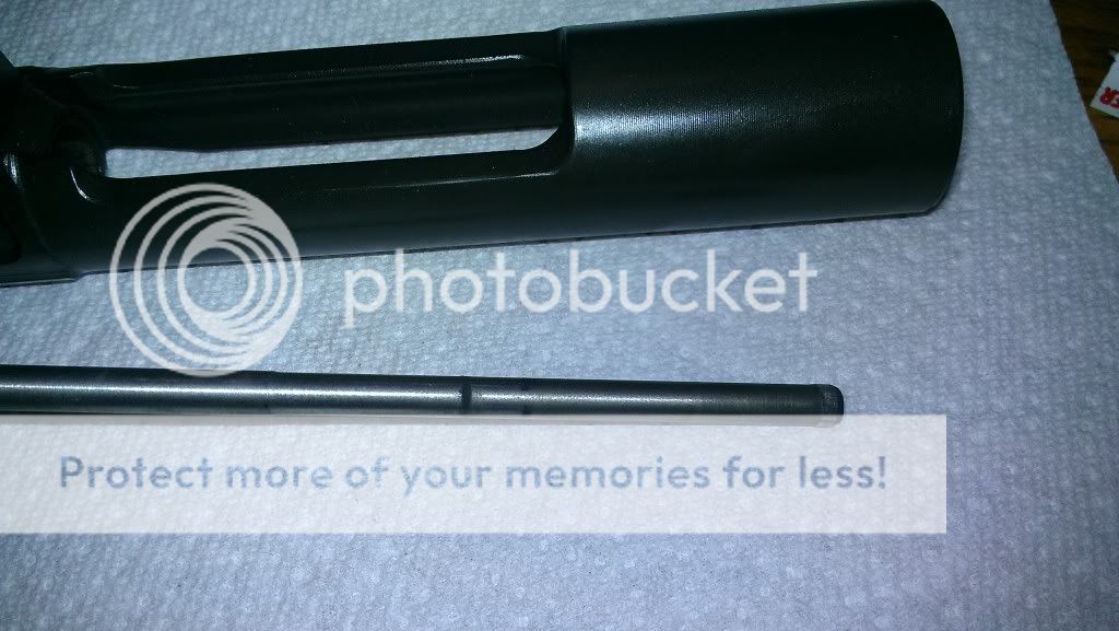

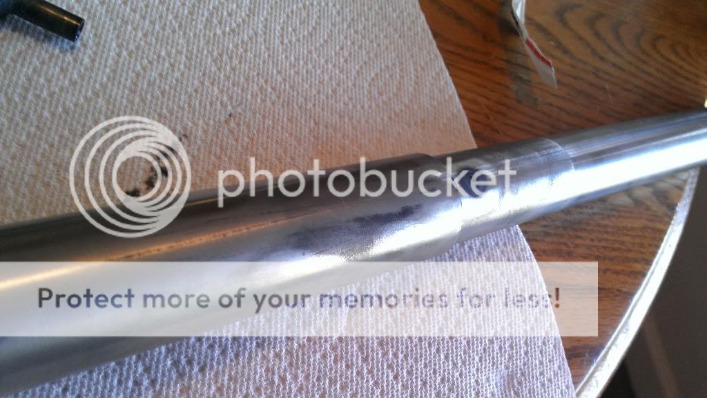

This is the gas port on the barrel. You can see the shroud of carbon around the port and some blow by on the shelf.
Someone please help. Problem with my target AR - AR-15 Discussion
Another view

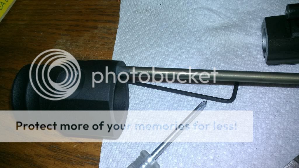

gas port on the block. You can see some blow by on the gas tube.
Another view of the gas block
Receiver end of the gas tube
From what I can see it looks like I have some sealing problems in the gas block. Now is it because the ports aren't lining up, or another problem? How do I insure the two ports line up?
Thanks for the help guys

Well if you temporarily remove the gas tube from the block then a bent paper clip through the gas block will help you line up with the barrel's gas port. I read that somewhere and think it was Sniper03 who gave that tip.

What Quentin suggested will work fine. An alternative albeit more lengthy process is to first make sure the opening in the tube lines up with the port in the gas block when pinned...this will determine if the gas block and the tube are in spec or need replacing. Now remove the tube from the gas block and align the port in the tube with the port in the barrel so that the center of the tube port is centered with the barrel port. Using a black sharpie make an index mark on the tube and barrel to be used to align the gas block. Insert the tube back in the gas block, making sure the port is facing down towards the barrel, and pin it securely. Slide the gas block onto the barrel and align the index mark on the tube with the index mark on the barrel making sure the tube is aligned straight to the opening in the barrel nut and receiver. Tighten down the gas block. At this point the barrel, tube and block ports should be in perfect front-to-back and side-to-side alignment. Relying on the shoulder cut in the barrel to align the gas block can be problematic if the ports on the barrel or gas block are the tiniest bit out of spec...not uncommon on some barrels, also that shoulder is cut to allow for a hand guard cap so the gas block is actually about 1/16" forward...

I have to say thanks to JPyle. He was correct. There was too much blow by around the gas tube. It was also leaking between the barrel and the gas block. I put a YHM GB on it and the problem went away.
