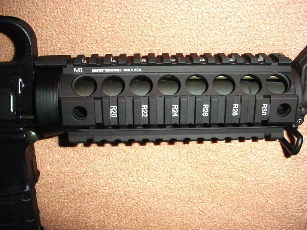

First, is cost. A nice 2 piece quad rail set up can be had in a carbine length for $110.00. Midwest Industries makes a really nice one. The second is ease of installation. A 2 piece rail can be installed in under 5 minutes by most anyone. About the only tool you need is a Delta Ring wrench which can be had for around $15.00. That is not a must, but it makes things a lot easier. These rails fit beautifully and are very solid. They can be used to mount a variety of accessories like the ones you mentioned in your post.
The biggest problem with a free float forend is they are much more involved to install. It requires more tools and a lot more work. About the only gain you'll get with a free float tube is slightly more accuracy. With a 16" Carbine you're not going to notice the difference. I have both on my AR-15's, and personally I'm not seeing enough of a difference to warrant going through the added labor and potential problems of a free float installation over a 2 piece.
Another thing to think about is if you go with the free float model and you have a gunsmith perform the install, that will also add more cost. Not to mention there is always the chance they could do something wrong. While unlikely, I've seen it happen. These are a couple of AR's I installed 2 piece forends on. Both are Midwest industries Models that I purchased here:
http://www.manventureoutpost.com/products/Midwest-Industries-Generation-2-Forearm-Black-4%252dRail-Handguard-Carbine-MCTAR%252d17.html
I was really impressed with the overall quality for the price. While there is nothing wrong with Daniel Defense, their 2 piece quad rails are substantially more expensive, and basically accomplish the exact same thing. I was a bit leery of going to a 2 piece model, but after I saw how solid they are once installed, I ended up putting them on 2 more rifles. I couldn't be more pleased with all 3.

I agree with Bill. But I will add that I like your choice. A two piece design allows installation without having to remove the front sight (or high profile gas block in your case). Its usually stronger, but also usually a bit heavier. Honestly tho I haven't done much research in 7" rails, so my knowledge of products on the market is limited.
If you are comfortable with removing the gas block I'd highly recommend going with a YHM low profile gas block, and free floating a longer rail over the GB. I think the YHM is the most inexpensive gas block I've seen ($35 ish). I'm almost 100% sure that that railed GB you have needs to go if you want a longer rail. Another even cheaper option is to buy a front sight post (i'm sure your armorer in your dept prolly has an extra lying around) and cut off the upper portion (the sight) leaving the lower gas block portion on. Besides being a cheaper option, these fsb are usually pinned on. Pinning is very stable. Pinned gas blocks are good.
