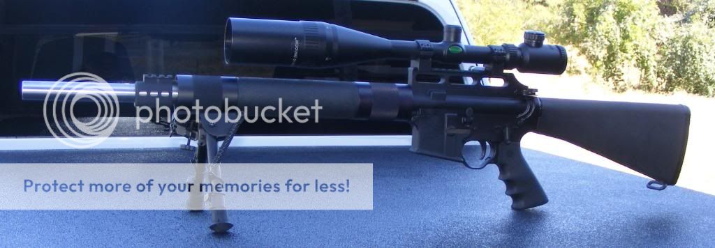

To the OP,The RRA Varminter is a great rifle.I have the 20" version,and a friend has an 18".Both guns shoot handloads in the 1/2-3/4 moa range.I don't shoot factory ammo so I can't say what it does.
As far as weight difference between the two-Not much,a few ounces.But they are a lot heavier than your standard AR.
I hunt with heavy barreled rifles,and they are no problem to tote around all day if you have the right type of sling,but the AR is muzzle heavy.
Rock River Varmint - AR-15 Discussion
55gr ammo is fine for plinking,but you will want to try out some 68-75gr match ammo to really see what the rifle will truely shoot good at longer ranges.I shoot a lot of 75gr BTHP match and 75gr AMax bullets out of mine.
