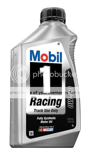

I'm a big believer in the automotive synthetic motor oils for my autos. I haven't used the Royal Purple (automotive synthetic adapted) but do use Mobil 1.
jammin .308 - AR-15 Discussion
If I ever run out of this quart I will look closely to these:
jammin .308 - AR-15 Discussionjammin .308 - AR-15 Discussion
