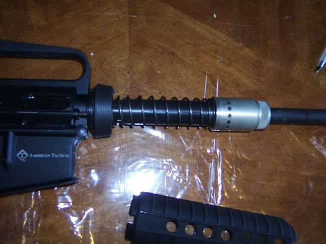

I found the issue and I will post pix in the am, it was simple, just I have no knowledge of this gas system

here is what it looks like, sorry but i dont feel like takeing that quad rail back off
if u look close on the muzzle end of the silver part the piece that part was lose and i tightend it up now it works fine

now that its working right the recoil is more than .223 it almost feels like a 7.62x39 uppper.
also this upper is half the weight of the light weight upper i just built. it feels like a toy
the front sight came lose once red lock tight fixed that good, but i would bet if dropped it could move on ya.
the anoing thing is that the flash hider keeps comming lose, even after one shot. there is no shoulder for it to but up to so u just tighten it to the end of the threads.

one more thing, look at the holes going all the way around the silver part on the barrel. when fired gass come out all of these holes and when i fired it for the first time it scared the crap out of me, i thought the barrel split or some thing.
I just picked up an ATI .410 Upper - AR-15 Discussion
when your hand is on that plastic hand guard and that gas comes out the holes on the bottom it will suprise u.
also after 10 rds i had quite the black spot on my hand.
funny thing about the rails, they didnt fit fight on my model 1 barrel but they fit this, guess its a good thing cause now i dont have to have my hand by the gasses. its just weird as hell to me.
