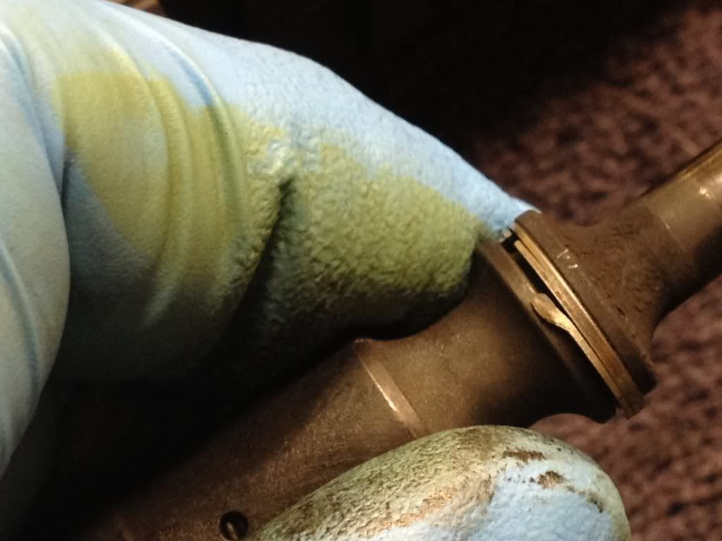

The last time I went out we went to a private range within a shooting range, and I worked the LMT hard....lot's of drills including rapid fire, double taps etc. The weapon was nice and wet and clean when I got there, and I kept it that way throughout the day. I gave the BCG at least two good squirts of Break Free CLP into the little lube holes, and in the housing, during the course of the session. Still, when I went to clean the weapon that night, I found a gas ring totally fried. I can only assume I pinched the ring at the last cleaning, which is disturbing to consider...... because in 30 odd years as a motorcycle mechanic and 1000's of piston ring installations, I never once broke a ring or improperly installed one. Nary a once!!!
My only thought also is that I used Break Free CLP on that BCG when I gave it a couple complimentary squirts. Turner's has been out of the Regular Break Free. I wonder if the cleaner aspect of the CLP reduces the straight lubrication properties at all? Somehow I doubt it.....but that gas ring burned up.
It is totally dry here because this is after soaking in solvent. I cannot tell if this is from a crappy installation or it got very hot and "seized" resulting in the edge of the ring snagging and being pulled out of the groove.

Acutally I have a Rainer Arms Thunderbolt BCG. On my first outing, the same thing happened to my rings. I cleaned and lubed my gun before my first outing with it. I was a little confused as to why it wouldn't cycle underpowered wolf ammo. But for PMC and milspec 5.56 it cycled just fine.
When I discovered the problem, I changed out the rings and just like that I shot 100 rounds of wolf no cycling issues.
Dunno what caused the problem, but it hasn't happened again in a couple thousand rounds.... I guess I can attribute it to plain old break-in pains.

thats the dirtest bolt ive ever scene.. looks like it was dipped in mudd. you should probly just order a whole new bolt and start over.
