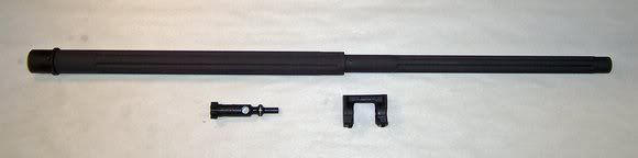

24" barrels are great for getting the velocity up, only real use is for hitting a long range target just a lil harder. They really shine with the heavier bullets.
The 24" model "1" barrel is chromed lined, and will hurt accuracy, kinda defeats the point of a 24" barrel.
If u do not want a bull barrel but still want a 24" barrel, do like I did and try to find a bushmaster varminter barrel.
Bushmaster 24" Fluted, Non-Chrome Lined Barrel based on DCM Competition design - button rifled 1/9 twist. Features a hybrid SAAMI Spec chamber with longer throat or "Leade" to accommodate 5.56mm ammunition. It is 1" in diameter out to the gas block with an 11 degree competition muzzle crown

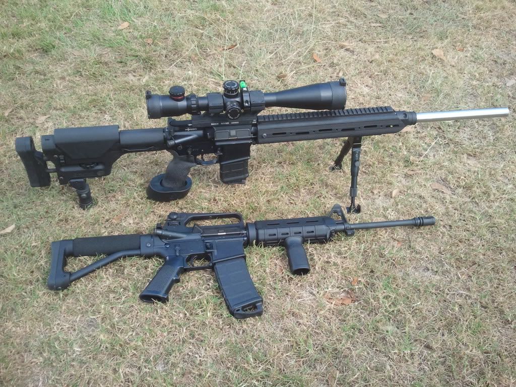

Originally Posted by JeffCooper View Post
I assume you know you won't be doing a lot of running around and shoulder firing with a 24" barrel...I've got a Colt with a 24" stainless and its long and heavy. It dwarfs my "built" AR. So Harris bipods and sandbags are your new friends. :-) The major upside is shooting long. I can blow the balls off a beetle at great distances. Don't get me wrong ...I love my Colt, but I quickly realized I needed a zombie killer.
well said, i has the same issue, so i built two
the barrel in this pic i just sold to replace with the 24" varminter barrel, this stainless barrel was a whole pound heavier than the complete rifle at the bottom of the pic, yes just that barrel alone weight more than a whole rifle
