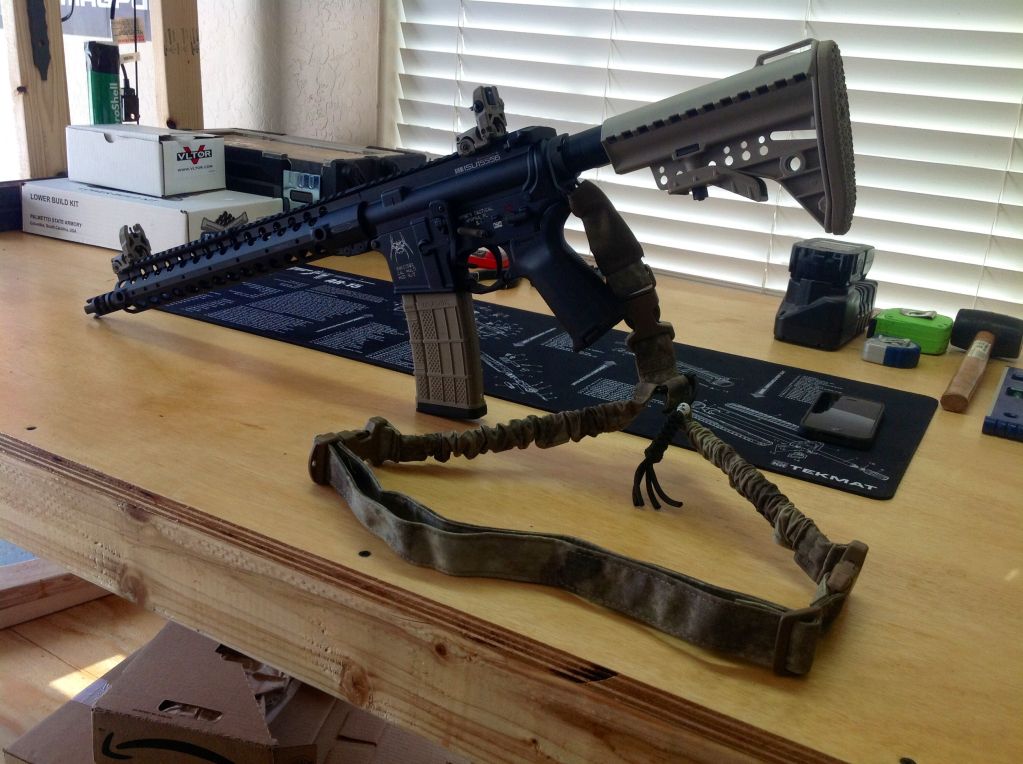

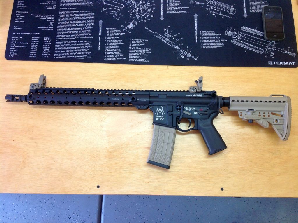

Just finished my wife's build. 6lbs. 8oz. Unloaded.
SPECS
- PWS FSC556 muzzle break
- BCM 14.5 LW barrel (standard) mid length gas 1/7 twist
- BCM low pro gas block & gas tube
- Centurion Arms 14" CMR handguard
- Magpul MBUS gen2 FDE
- Iron Sight 15 ISU15556 upper receiver with BCM forward assist & ejection door installed
- PSA BCG (full auto)
- BCM Gunfighter charging handle mod5 (small)
- Spikes Tactical forged lower receiver with Spikes billet trigger guard
- Spikes ambi safety
- PSA LPK (minus FCG which is BCM stock trigger)
- KNS anti rotation pins FDE
- Magpul BAD lever
- Magpul MOE+ grip
- IKH S.L.A.P. end plate
- PSA Buffer tube, spring, and carbine buffer
- VLTOR imod stock FDE (battery compartments removed)
- Lancer L5 AWM in FDE
- Condor Cobra single point bungee sling in ATACSAR picture thread - AR-15 DiscussionAR picture thread - AR-15 Discussion
I forgot to put the Vortex SPARC on so here it is on with butler creek flip caps and 1/3 lower co-witness
***if anyone has the VLTOR imod (standard) in BLACK and wants to swap battery compartments, rubber buttpad, and latch inbox me. I'm looking to swap these parts to add some black to the stock
