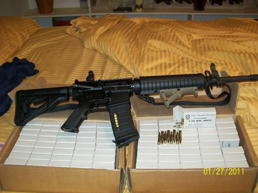

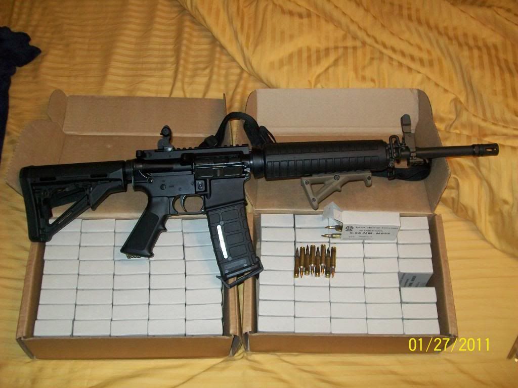

ordered RRA upper -- flattop, 16-inch mid-length w/heavy barrel and RRA flip front sight and gas block combo, M4 feed ramps, forward assist, and brass deflector. ordered April of 2009, received November 2009;
paired with a YHM (Yankee Hills) lower, and RRA 2-stage trigger and lower parts kit; MagPul CTR stock, MagPul AFG (angle forward grip);
YHM flip rear sight.
laid the parts kit out according to a diagram i found online (PM me if you want it) on a white bath towel (if you use a towel with the "thread" poking up, it tends to hold the small pieces in place), walked myself through step by step, and all i needed was a small hammer, a pair of needle nose, and a razor blade...........no tape, no punches, nothing else. THE BIGGEST THING IS TO TAKE YOUR TIME, AND MOVE SLOWLY.
oh yeah, plan on getting a floating handguard @ a later date.
