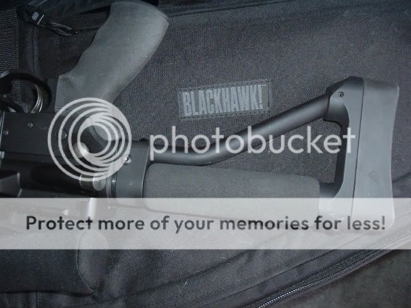

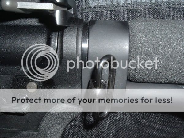

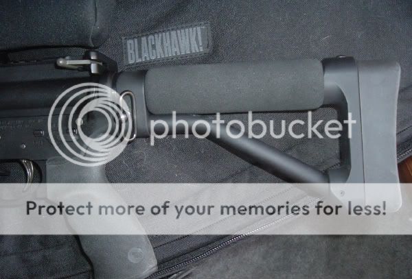

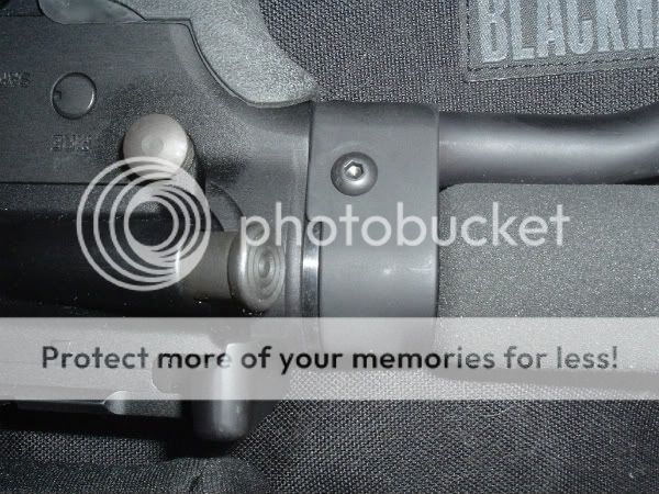

Yes, I have the ARFX-E (entry or short) stock with the 1" butt pad. I love it and have it on my 16" pig gun. I think you would be better off with the ARFX stock for your 20".

Originally Posted by Steelersfan View Post
What are your Opinions?
Get it. You will love it, unless you need an adjustable cheek weld.
Ease of instilation?
Easy-peasy. Just remove your A1 stock and slip this baby on. Be sure to soap up the extension tube. The foam cheek is hard to slide on without it.
What else would I need to buy in order to attach it to my Lower receiver?
I am guessing I need the Extention tube, buffer tube and spring as well as a lock ring. DO I NEED AN END PLATE?
Thanks for any help.
Needs to have an A2 extension tube installed. End plate is on the stock.
Here's where you need to go, give them a call and they will make sure you have everything needed.
