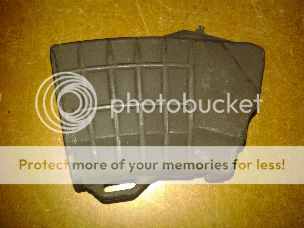

Wouldn't have been that much trouble The outer diameter of the tube I used is ~27mm and wall thickness 2,55mm so look for something like that and it should fit quite well. I didn't take the bullet guide out yet because I didn't have my heat gun (for the loctite in the threads) close to hand, but I eyeballed it with calipers and it's ~20mm long, ~15mm wide. It's not like you're doing brain surgery when you drill the hole, just make sure you get it straight. You can go all the way through the trunnion, but don't drill a hole to your receiver.
Here's a (crappy) pic of the bullet guide. Yes, I know it's dirty
Saiga AK and standard AK magazines - AK & SKS Discussion
I meant that the MK-versions may have the bullet guide. The EXP-01 most likely won't have it, but it doesn't hurt to ask from the gun shop. Also, don't file the AK magazines. File the magazine catch, as the original Saiga mags will still work in the gun with very minor modification.
Italy, cool! Been there a few times. Cattolica, Pesaro and Venice on vacation and just last summer I was in Breganze on a work trip for three days. You sure have some interesting gun laws there
The RK mags can be modified permanently. The shorter mag in the picture used to be a 30 rounder, now it takes only 5rds. From the second pic you can get an idea how easy it is to shorten these mags. You just "cut" the vertical ribs and then file the horizontal ribs until the base plate can fit on them.
