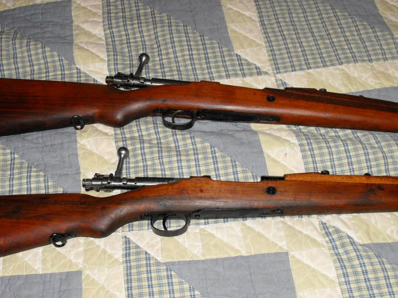

OK, Stocks on pre war and early war rifles were Walnut w/ flat butt plates, about 1941 give or take a few months either way depending on the arsenal, they went to a laminate stock w/ a cupped butt plate. Many post war and early war rifles went to the Eastern front and were captured, so many variants where there. Capture screws are to put it simply small screws that keep bigger screws from moving. These are Yugo rifles, but if you look at the screws forward of the mag you can see 2.
