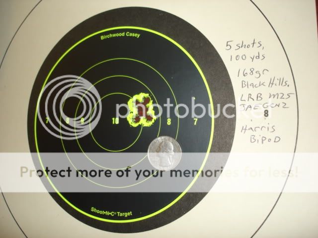

Re accuracy, here is a rundown of some of my rifles.
An early 90's Armscorp M14 that is completely stock(photo below). I dropped it into an old birch GI stock (no bedding) and proceeded to fire several 5 shot sub MOA groups with iron sights (which honestly did surprise me). No mods at all, and with a Winchester chrome lined bbl. It even has a Chinese bolt (one of the good ones, though). So I put it into a JAE stock and scoped it. I prefer synthetic to wood as well, so sold the birch to a guy on another forum.
A custom built SEI with Krieger med wt ss bbl in a bedded McMillan M1A stock that is boringly accurate. I've used it with irons in a sniper class and wondered why I even bother with scoped rifles. This rifle is a retired Camp Perry rifle. It has all the cool bells and whistles, but is old, well worn and bitchin.
A standard wt Springfield built by Ronnie Morris in the late 80's. It is a full NM grade, standard wt rifle. With old Portugese ball it used to turn in 5 shot groups at 100 yards that were all touching (nickel sized groups?), with iron sights. I have not fired it in over 10 years, but have no reason to assume it wouldn't shoot that well again. It may get dragged to the range next month, just because.
And here is a representative group from my M25.
LRB M25 and Armscorp with JAE G2 stocks and IOR scopes.
