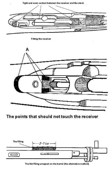

No bayonet was the reason I didnt get one...
Im pretty sure the reason they shoot better with bayonets, has to do with barrel harmonics..
Why else would the Russians give their snipers (Who didnt get a bayonet) a gun that was sighted in and shot better with a bayonet?
The Russian military Mosin manuals Ive read have a section on wrapping the barrel in a certain location, to change the barrel harmonics; that has better effect than using the bayonet...
I posted this in another thread but ill put it here too:

The picture is the same as the other thread too. Blank. So, kind sir, could you re post the pic it so kindly give us a description.

Ok ill try again... Its not the same pic from the military manual, but shows the same thing, and in English!
