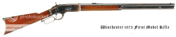

Your MODEL 1873 was produced in early 1879.
I could use some help identifying a 1873 Winchester. - General Rifle Discussion
Model 1873 First Model Rifle
- serial numbers approx. 1-30,000, sliding thumbprint dust cover on 2 guides which are an integral part of upper frame, absence of any cal. marking.
$2,500 - $4,950 (Above Ave.) $1,650 - $2,500 (Average) $900 - $1,650 (Below Ave.)
Since early Model 1873s were only made in .44 cal., no caliber markings are present. With the introduction of additional calibers, barrels (just in front of the receiver) and the brass elevator were stamped with the caliber.

If only it looked as good as the one in this picture does.
