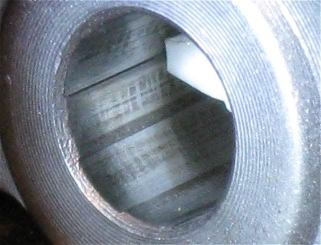

After I cleaned it to my satisfaction, I took a pic of the throat to see how clean it was and found a ring of unworn metal where the carbon ring resided.
How to break in a barrel properly? - General Rifle Discussion
The ring isn't what is important, but the roughness of the barrel. That is perfectly clean, and it isn't mirror like whatsoever.
So I thought if I tried a break-in procedure, I might get that ring to dissipate somewhat.
I didn't shoot 100 shots in the air further using-up my barrel life. I instead took shots as I normally would have at targets and distances I usually do. Probably took me months to do, since I take one shot a day with whatever rifle I choose to shoot at that time. It is quite possible that the shot taken in my icon was shot during the break-in period. (Which is a one shot one hit on a 6 inch square at 400 yards.)
Here is what the barrel looks like now.
So I have a smoother bore without shortening barrel life; (per your link,) "every round shot in breaking-in a barrel is one round off the life of said rifle barrel."
And did I mention it shoots wonderfully?

That's a mighty pretty barrel! What ever you did obviously worked
But, as a newbie I lost track and am confused now... Did you follow any break in regiment or just clean? Do pistols need any special treatment?

I have a Model 94 I bought in 1973 and the bore of it looks about like the above pics. I never shot it more than 20 times, or one box of ammo at a time. It was my first rifle and I always took really good care of it. I carefully cleaned it after each use. It still shoots a nice tight group at 100 yards. I used the foaming bore cleaner named Wipe Out on it and got even more fouling out of it that might have been in there for a long time.
I used a break-in procedure most resembling the one Winchester suggests.
Winchester: Customer Service: Questions & Answers: Question 223; What is the recommended procedure for breaking in a new barrel?
For the first ten shots we recommend, if possible, using jacketed bullets with a nitro powder load. After firing each bullet, use a good copper cleaner (one that has ammonia) to remove copper fouling in the barrel. If you look into the end of the barrel after firing a shot, you will see a light copper-colored wash in the barrel. This must be removed before firing the next shot. Somewhere in the procedure at around shot 6 or 7, it will be obvious that the copper color is no longer appearing in the barrel. Continue applications through shot 10.
If you have any ammunition left, you then may shoot two rounds and clean it for the next ten shots. This is simply insurance that the burnishing process has been completed.
But I suggest using the recommended break-in procedures outlined by the specific barrel manufacturer; they'll know what is best for their products.
