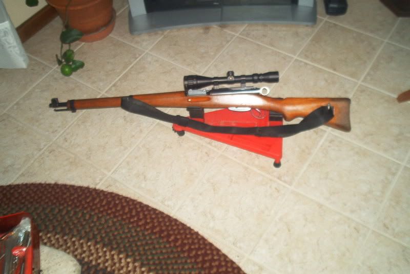

They did, or the company that became Glock did. Wonderful rifles!!
From Years ago w/ St. Marie mount. Mount is gone, rifle is safe and sound. They are over engineered.
