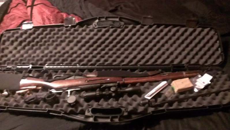

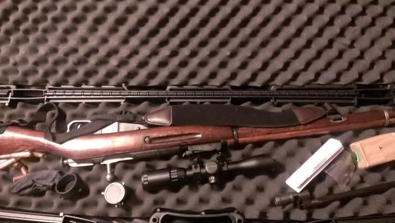

That first rifle is beautiful! What is it?
Here's my mosin nagant.
Bolt Action Rifles. - General Rifle Discussion
In it's case next to the scope I'll be putting on it next week when my brass Stacker gets here.
