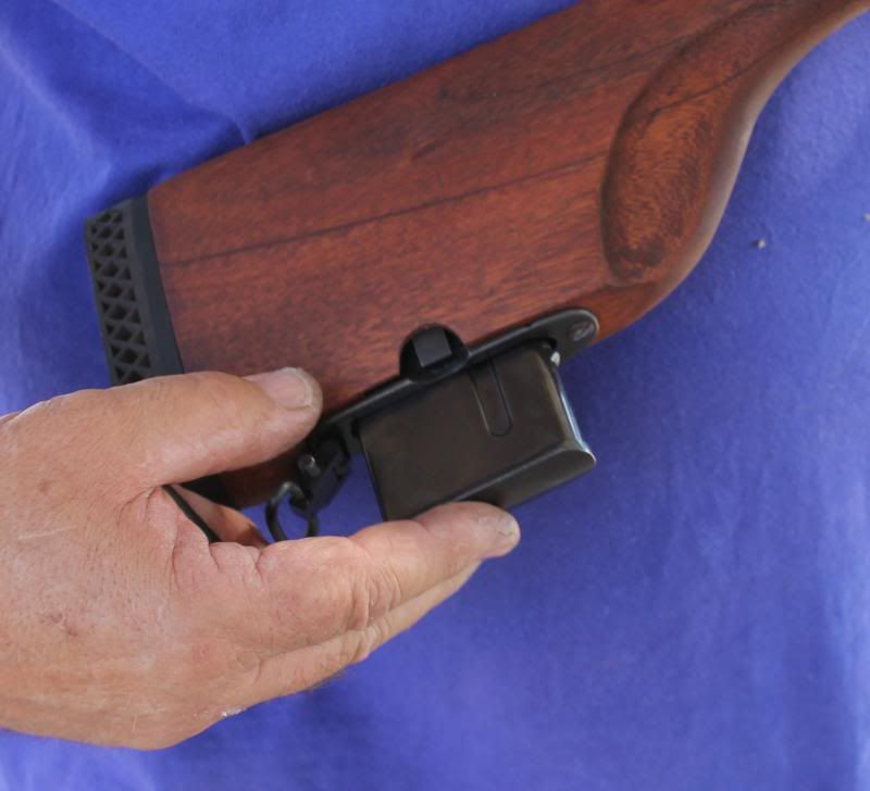

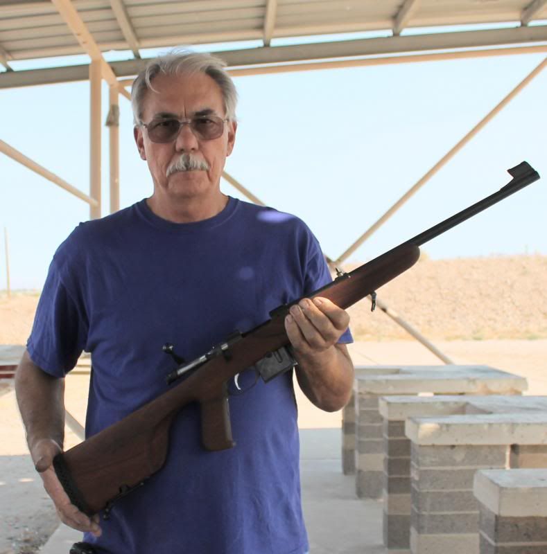

I have one bolt action rifle - CZ 527M...what it looked like when I got the little gem,
Bolt Action Rifles. - General Rifle Discussion
And after a buddy gunsmith took an idea of mine and ran with it,
This group was fired at 110 paces, standing.
It was the best of a good day.
Action is pillared and bedded, and he pillared and bedded the old stock as well, just in case I wanted to switch back for any reason.

very unique and i like it! very different than the norm for sure. it looks like it would be fun to shoot as well. thanks for sharing that with us!
and that's thinking outside the box for sure!
