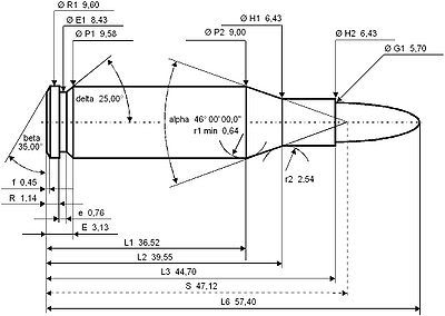

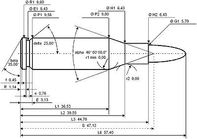

Originally Posted by Vincine View Post
I think I saw a SMALL difference in the angles of the neck when looking at the specs on the cartridge blue prints. I think JTJ’s right. The bigger difference is in the rifle’s firing chamber, not the cartridge. RRA uses something called a ‘Wilde Chamber’ design which allows both to be shot without difference. I had been looking for a bolt action with a ‘Wilde Chamber’ to allow one to shoot either .223 or 5.56, but there doesn’t seem to be any.
I think I saw a SMALL difference in the radius angles of the neck when looking at the specs on the cartridge blue prints giving the 5.56 a longer throat. I think JTJ’s right. The bigger difference is in the rifle’s firing chamber, not the cartridge. RRA uses something called a ‘Wylde Chamber’ design which allows both to be shot without difference. I had been looking for a bolt action with a ‘Wylde Chamber’ to allow one to shoot either .223 or 5.56, but there doesn’t seem to be any.

Originally Posted by billt View Post
The external case dimensions are identical. The only difference is in case thickness and in the freebore of the chamber itself.
5.56 MM
.223
Also from http://www.accurateshooter.com/cartridge-guides/223rem/
>There ARE differences between the .223 Remington as shot in civilian rifles and the 5.56×45 in military use. While the external cartridge dimensions are essentially the same, the .223 Remington is built to SAAMI specs, rated to 50,000 CUP max pressure, and normally has a shorter throat. The 5.56×45 is built to NATO specs, rated to 60,000 CUP max pressure, and has a longer throat, optimized to shoot long bullets.<
If look carefully at the shoulders you’ll see every so slight different specs for r1 and r2.
