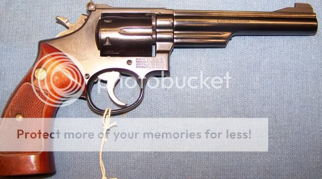

Thanks for the info guys. I've got a 19-3 Combat Magnum coming tomorrow.
Got a great deal and it will be a shooter.
This will be my first 357 Mag. I feel like a kid again/still!

Cane, nice looking Mod.19, all pinned and recessed to boot. If you decide you just can't live with it, throw it my way and I'll give it a home.
