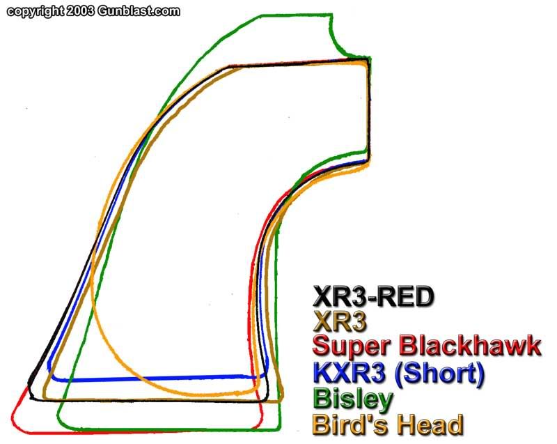

There are three different versions of the vaquero grip frame i know of. Call ruger with your serial number and they will be happy to tell you which frame you have. Then you can find grips.
Installation is one screw and easy to do. Just dont over tighten they can crack

I don't know that much about the vaquero. I do have a lot of experience with the Blackhawk. Grips and other parts are not as model specific as one might think. I ditched the internal lock on my Blackhawk by bolting on an XR3 grip frame. The XR3 grips required fitting with an emery board. A friend bolted on a grip frame from a Bisley Vaquero on a new model Blackhawk. I am sure there are other parts that are interchangeable.

There are a few differences in the various Ruger handles. Make sure you knw which you have:
