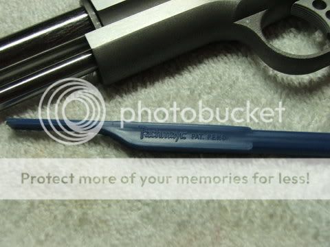

OK let's do another one;
Pachmayr Widget Assembly Tool for the 1911
Make your life a little eaiser! - General Handgun Discussion
The inexpensive, must-have tool for any 1911 enthusiast.
Have you heard of (or worse, made the) evil crescent of shame on your 1911 frame? By using this tool you can avoid scratching the frame when installing your slide release/thumb safety.
It is ideally suited for the 1911-style handgun.
Made of a non-marring blue polymer so it will not scratch even the finest firearms.
Material:Polymer
Dimension:
• 6" long
• 0.25" x 0.25" thick
Features:
• Designed to depress the plunger tube spring, simplifying assembly and disassembly of tightly fitted 1911’s.
• It can be used with almost any gun
• Will not mar finish of gun parts.

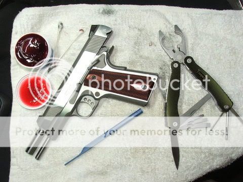

I have owned this tool for a year now and have used it every time I work/clean my 1911's.
Can I do without it? Yes.
Do I enjoy using this? Yes.
Is it worth the $4? Meh Use the cap from a bic ballpoint.
It does work Make your life a little eaiser! - General Handgun Discussion , but it really needs to be stiffer. It is quite flexible and requires some getting use-to. I have however, experienced the protection it provides my guns from the dreaded crescent scratch of shame!
Pachmayr®
MidwayUSA - Pachmayr Widget Assembly Tool 1911 Polymer Blue
Canebrake rating: Make your life a little eaiser! - General Handgun Discussion Meh. Buy it if you want.
I think for the price you should jump on this great tool! A quality built tool that should last you a life time.
It's a canebrake work bench regular (WBR)!
Old 02-20-2009, 03:04 PM   #24
Liked 3510 Times on 1617 Posts
Have you heard of (or worse, made the) evil cresect of shame on your 1911 frame?
*raising hand sheepishly *
Guilty! Did it on my first 1911. I didn't know it didn't rotate into place... LOL
One of the reasons the gun will be refinished...
