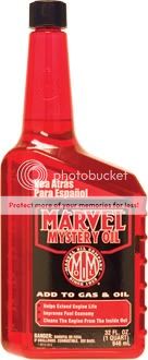

  • Lube(s) (can't beat the default; Rem Oil)
    I blend my own. Cane's "Mobil Mystery", 90% Mobil 1 / 10% Marvel Mystery.
    Hand gun cleaning & maintanence - General Handgun Discussion + Hand gun cleaning & maintanence - General Handgun Discussion
