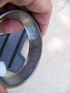

The carrier just fell right out, I didn't even need a pry bar. What I previously thought was a crack in the housing is just a minor casting imperfection where the cover bolts to the case. The wear on the axle shafts appears to be minor and caused by wearing on the axle seals. The axle seals look like someone took a jack hammer to them.
The bearing are definitely hosed though, these pictures are of the long side bearings and race:
Sorry about them being so big, but low res pics just didn't do them justice.

WOW those bearings are smoked huh. Prob why the carrier fell right out. By the looks of those I would be looking at the pinion bearings also.
Did this thing run low on fluid for a while ??

Definately check those pinion bearings if your going to rebuild this. You'll need to get a new crush sleeve for the pinion now. How does the ring and pinion gears look? Spyders and sides?
