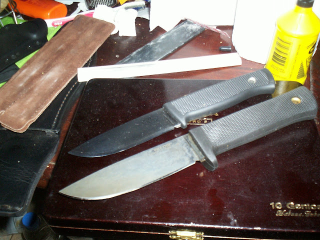

Rust is the other big issue in knife maintenance. Something that, in my opinion, is often blown out of proportion. Machetes, made out of steels like 1055, are the most used tools in tropical rainforest and they seem to hold up just fine for years. As long as you dry your knife before putting it back in its sheath, you’ll be fine. Some surface rust might show up here and there, but it’s nothing to worry about. If it gets too bad just use some sandpaper to remove it.
I don’t recommend painting or cold blueing your carbon steel knife, those things are toxic and you don’t want them in contact with your food. There’s a cheap and easy alternative that will afford your knife some rust protection: a forced patina. If you’ve seen well used carbon steel knives, you probably noticed that the blades are black or gray, stained from contact with different acids. This is a sort of very thin layer of surface oxidation that helps keep rust away (like blueing on guns). Your knife will develop this patina over time, but you can also force it. Just leave the blade in vinegar for a little while, or cover it in mustard. 1095 steel used in Mora knives takes a nice deep patina very quickly.
If you decide to carry oil in the field, get some food grade mineral oil. It’s basically baby oil without the perfume and other crap, it’s dirt cheap and available at drugstores.

An example of patina on carbon steel. The top knife is a stainless Fallkniven F1, the one below is a Master Hunter (Cold Steel) made by Camillus in Carbon V. Although the picture is less than perfect, you can see the matt grey colour of the flat ground blade contrasting with the shiny edge bevel.
