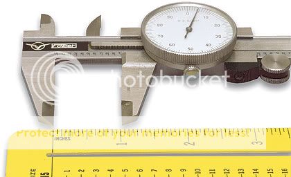

Ask most shooters to define minute of angle (MOA) and you'll probably elicit the reply, "It's an inch at 100 yards." A purist overhearing this will almost certainly chime in with a smug correction to the effect that a minute of angle is really 1.0471996 inches at 100 yards, but if you're numerically challenged and ask nicely, you may round it off to 1.05 inches. As a lifelong nitpicker, I admire the precision the purist brings to the party, but as a shooter I think I'll stick with a simple, useful, rounded-down inch. After all, even at 1000 yards the additional decimals don't quite add up to a half-inch. I, for one, cannot hold close enough at that distance for the discrepancy to matter.
Free Pass on Stupid "?" Thread - The Club House
The jaws of the caliper indicate the formal value of minute of angle (MOA) at 100 yards, 1.0471996 inches, allowing for vagaries of operator interpolation and mechanical tolerances. The ruler shows 1 inch, the commonly accepted value of MOA at 100 yards.
The MOA is a useful tool for shooters because it varies in direct proportion to distance. Our nominal inch at 100 yards is a half-inch at 50 yards, 2 inches at 200 yards, 3 inches at 300 yards, and so on. This makes it possible to calibrate adjustments for range and windage on precision iron sights and optical sights in easy-to-use standardized increments of fractional and whole MOA.
A typical hunting scope is likely to have adjustment dials click-stopped and marked at minor intervals of 1/4 MOA with major calibration marks at 1 MOA intervals. A high-power scope for benchrest, target, or varmint applications may have 1/8 MOA adjustment capability. And it's not unusual for red-dot handgun sights to have coarser adjustment intervals of 1/2 MOA or so for convenience at typically shorter handgun distances.
Not all scope adjustments hew to the familiar 1/8, 1/4, 1/2 increments. European optical sights usually feature MOA increments attuned to the metric system. A case in point is the Zeiss Victory Diavari 6-24X 72mm long-range model, which has 1/5 MOA clicks that correspond neatly to a 0.5cm shift in point of aim at 100 meters. Closer to home, I have, and still happily use, an aging Burris pistol scope that was made with 1/6 MOA adjustment intervals.
