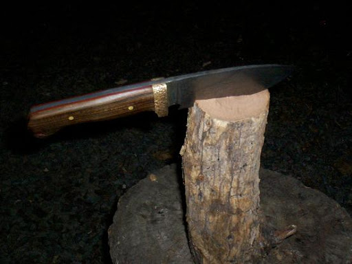

In this picture, the log I'm splitting is too thick for that knife. Notice how small an area will be exposed after the first few blows drive the blade into the wood.
Here you can see a more sensible blade to log ratio, with plenty of room to hit the spine.
These pieces of wood were carefully battoned off of much larger chunks using Mora knives. The models in the pictures are a bit smaller than the Clipper and they lack the rubber cushioning on the handle.
Some have been carved into feather sticks and the rest were further split to get to the dry interior (it rained the night before)
