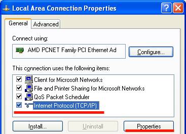

Click Start -control panel - network and internet - network and sharing center - change adapter settings. (I'm using win 7 so it might be slightly different for you) I'm trying to get you to a window that looks something like this only its for wireless not LAN.
Once there highlight the TCPIP V4 option and click properties. Does it say obtain and IP address automatically and obtain DNS automatically? If those options are preset, this is likely your issue. Write down the numbers before changing them so you remember.
Last suggestion of things to try to help with troubleshooting. On your computer click start - accessories - command prompt. At the command prompt type the following without quotes "ipconfig /all" compare these IP addresses listed (for the Wireless adapter) with the ones on your mom's computer. The only one that should be different is the IP, not the gateway or DNS. Also DHCP should most likely say Yes on both computers but it may not. If it's set to NO then you have to give your computer an IP address manually.
